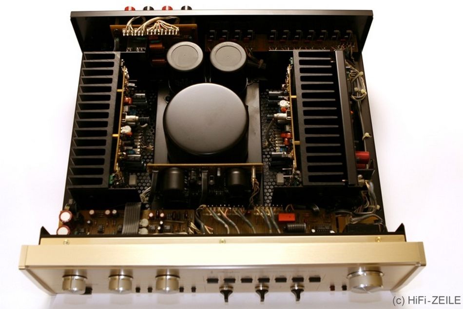

One thing that never is mentionned on brochures of any kind, is the damping factor needed for a speaker to perform. This is the amount of current the speaker cones will need to have the proper grip on their performances. Some speaker can be thirsty of damping factor and will need lots of watts to perform well. BUT... those are not so much on the market and they tend to appear more and more in the top posts of hifi madness. A "normal" speaker should be easy with around 40w to 80w (per channel/ performance given under 8ohms) amps.
In general, in hifi, you search for speakers that are working well in your room regarding your given budget. Because every speaker will behave differently in a given room. When you found that, then you search a matching amplifier ; in general, honest hifi sellers will recommend you their best ponies for this or that speaker type. PLEASE, DON'T INVEST THOUSANDS IN THE AMPS, there is no reason to do so, unless you are researching some esthetic qualities that those expensive amps have. Other advice, you can go for used amps of the 70's/80's era that are, generally, quite well made. Have a look for models with pcb boards and bulky components, that, often, will be repearable by a skilled radio tech from your city. We could call them "immortal", as long as you invest into regular services all twenty years.
