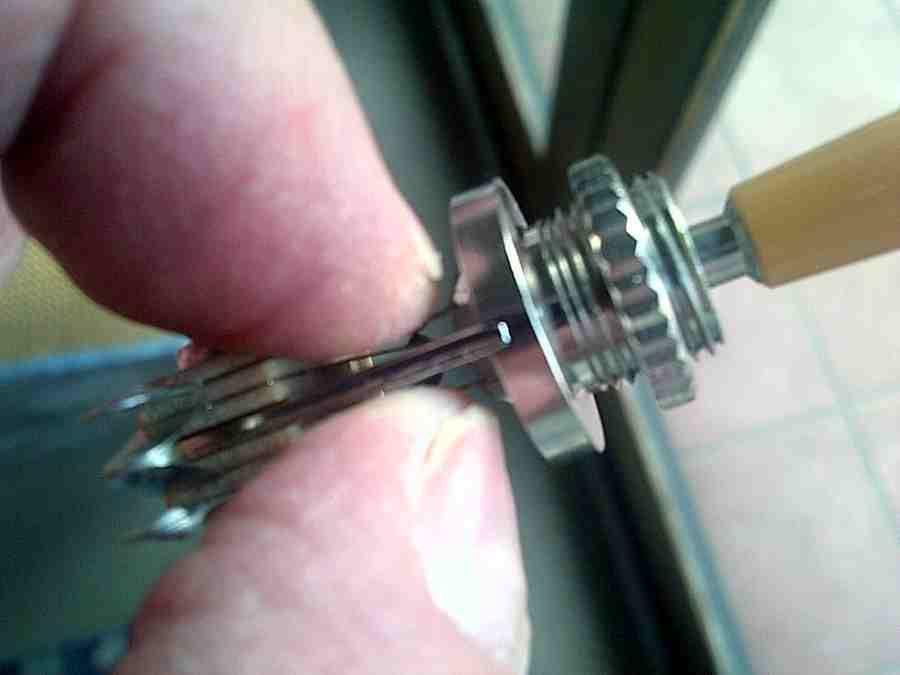

Hi all I have a LS95 or 98 BB from around 2010/11 with PAFs not P90s. The pickup switch jumps out of neck position into the middle and most of the time I get bugger all volume out of the bridge pickup because of the switch.
Which switchcraft replacement should I be looking at getting and also if I upgrade the pickups/pots and wiring, do I need short or long leg pickups and pots?
I'm aware the CTS pots will require the holes being opened up slightly.
Any help would be greatly appreciated. Thanks in advance.

If it's just jumping out the neck position, but still works fine, no need to replace it.
Take it out and squash/bend closed the two plates, that should sort out the problem.

Diamond wrote:
Did it work?
Switch is better than it was but still not like it should be. I'll change it out for a switchcraft. Thanks
