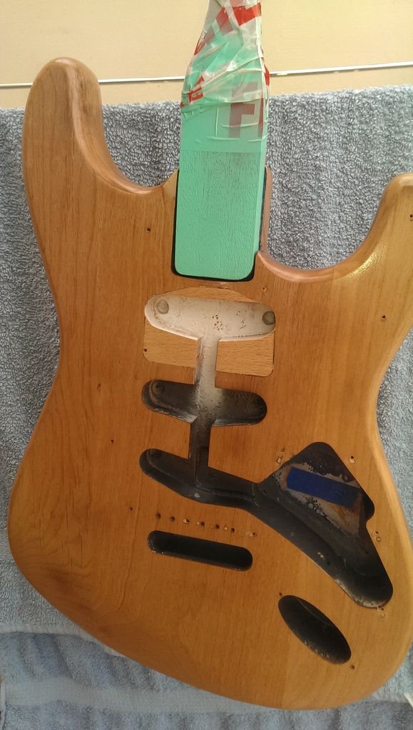

Routed some clean edges today for the new wood block inserts
Glued and clamped overnight using Titebond
il sand grain fill and apply sanding sealer next time.

Today i plugged the extra holes with cocktail sticks and used a tiny amount of surface filler ,then applied some grain filler and sanded out , sorry no photos of that part,then i applied 2 coats of nitro cellulose sanding sealer, the wood ( sen Ash?) has taken on a nice amber colour now.il leave overnight to dry and then prep for primer.Ive masked the body codes off to protect from colour coats.I had noticed once i had routed the pickup cavity the surface was a lot smoother than the middle and bridge cavities, the factory seem to laquer over the dust ect and this leaves small bits under the surface , so to replicate this i used some sawdust and spinkled this in the cavity before i laquered .

Applied the first primer coat today
you can see the sawdust crumbs ive added to the neck pickup cavity
just a little filling to do then il apply a Black guide coat which is an automotive product, a dry powder is applied to the white , then when you wet and dry this off any low spots will show as black.
