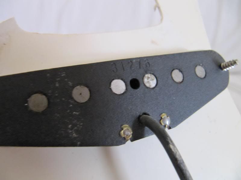

The pickups in that picture are from a 1976 strat, pickguard has a 1976 maxon date code.
The Super Real era pickups were still made by maxon but look a bit different.
There were 2 different types of pickups: PU-S5 (used on SE-500 and SE-450) and PU-S8 (used on SE-600 and SE-800)
So you?d need to have pickups from a Super Real era SE-600 or SE-800. (look for the date code on the pickguard, 2nd digit is the year)
The maple neck SE-800 Super Real also featured a painted aluminium pickguard originally.
This is a pickup from my 1981 SE-600
