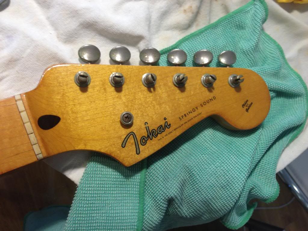

Thanks mate, still loads of work to do though... the early Tokais all had the decals underneath the lacquer, so need a few coats on top, followed by a fine sand & polish. Will post updated pics!

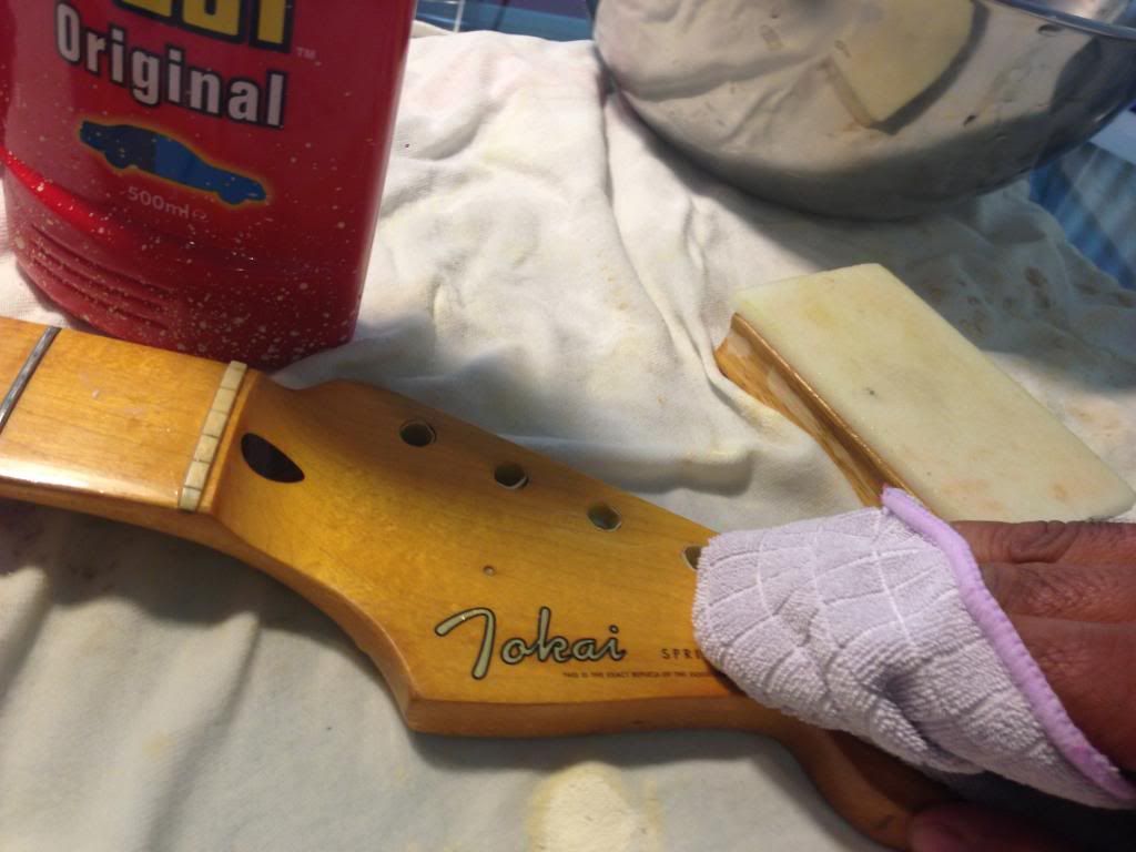

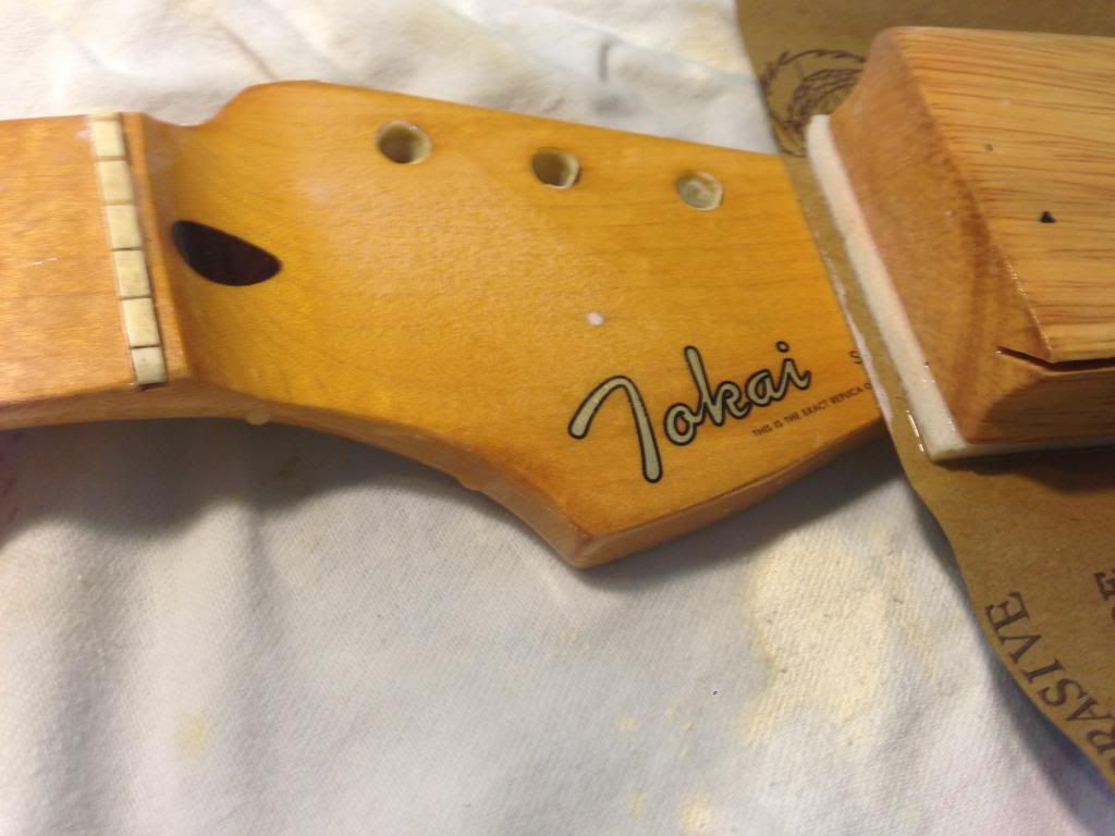

After several coats of clear nitro, flattening the paint with 600 then 1200 grit wet & dry:
A final polish:
Then distress the lacquer a little with a few very small random knocks and scrapes (and a little scratch off the decal!), and re-fit hardware... The colour looks ok, it looks reasonably aged and in keeping with the general wear on the rest of the neck. All finished, now for the body and neck plate:

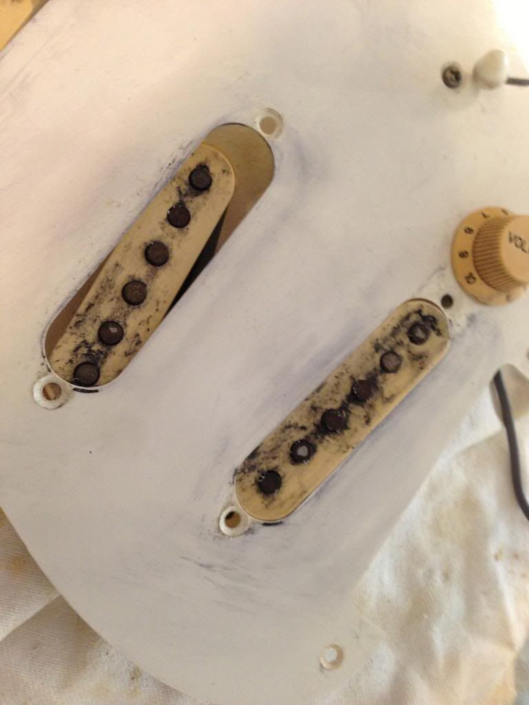

The pickup covers and pickguard were at some point painted. We've all done strange things to guitars before, what the heck is this? The paint had been mostly removed from the pickguard, but heavily scratched in the process:

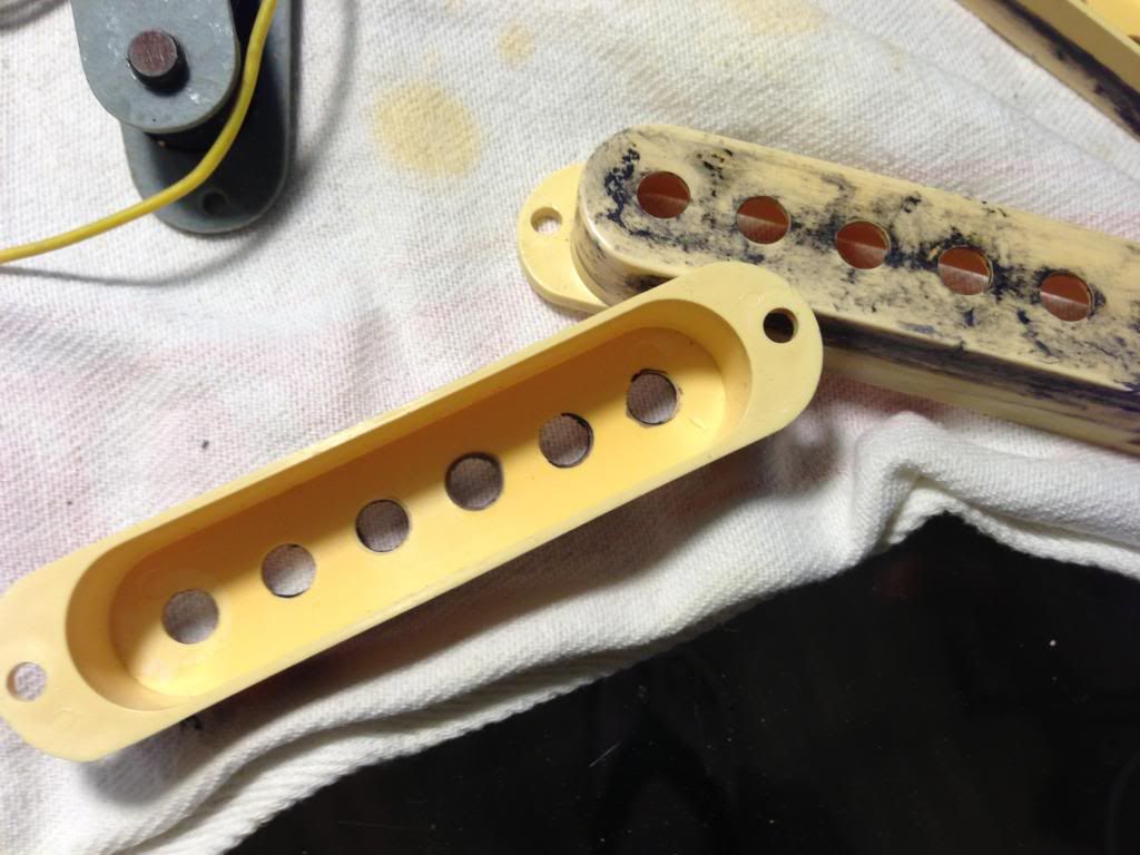

The Pickup covers weren't original. Original Tokai ones don't seem to age much at all. Looking inside, these are the same colour as the outside and look like cheap aftermarket cream covers. These are therefore going in the bin, in favour of some Fndr original aged cream covers:

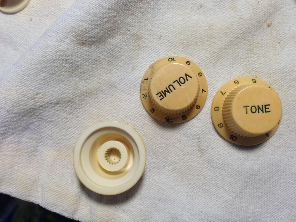

The knobs are original, and will be kept:

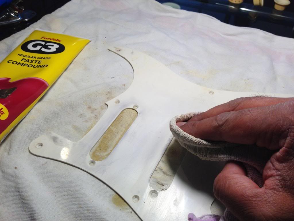

The pick guard needed some very aggressive polishing:

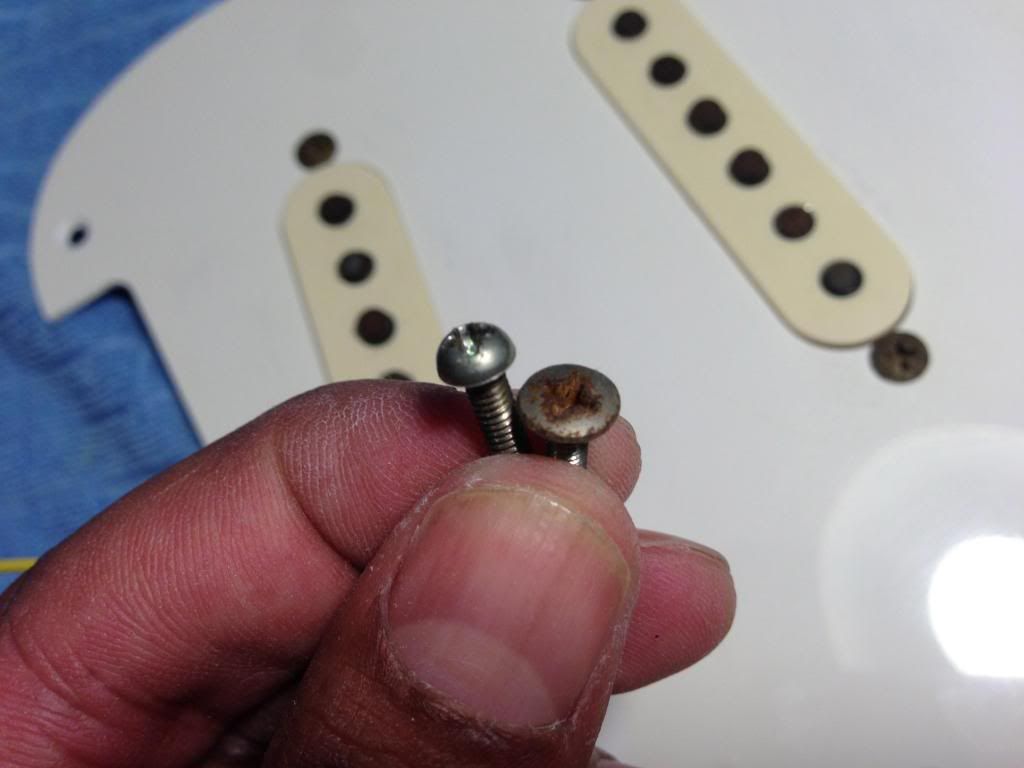

The round head screws for the selector switch (left) were not original, and were replaced with proper countersunk mushroom head screws, aged in acid (right):

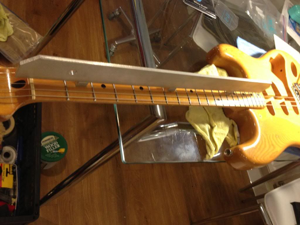

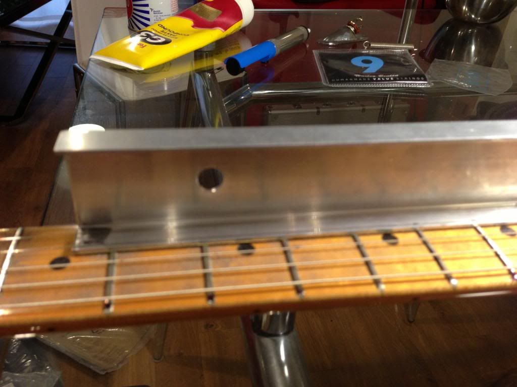

Neck back on, with strings tensioned correctly, and adjusting truss rod until neck perfectly straight:
Fret dressing with strings on:

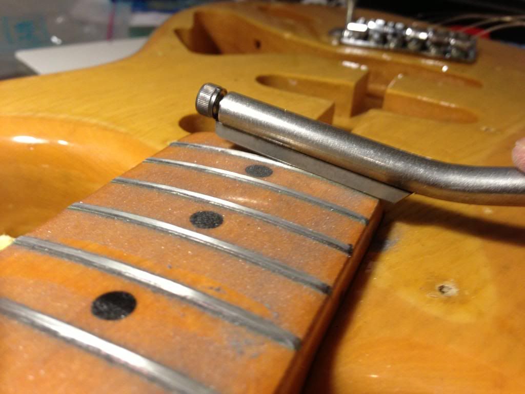

Nearly there... crowning the frets:

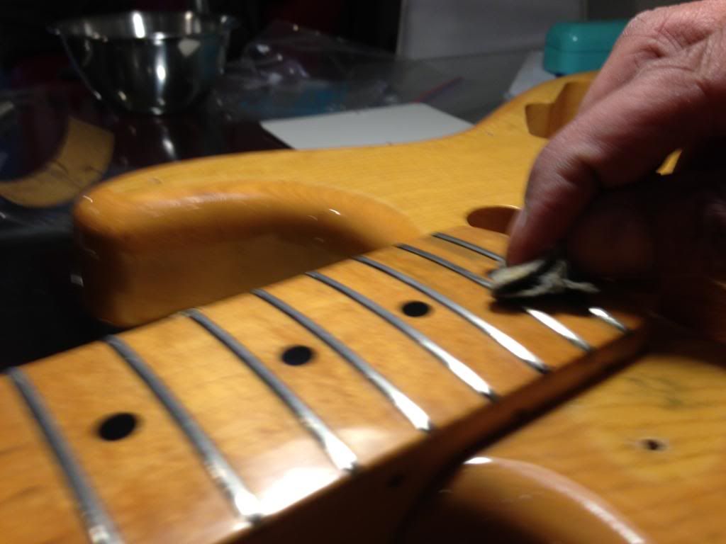

Fret polishing... Just the final assembly next:

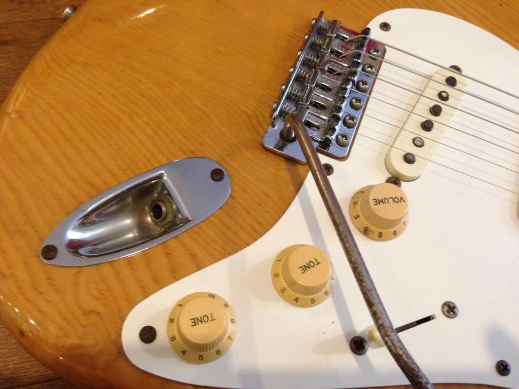

Finished result (the last set of pics, I promise!):
