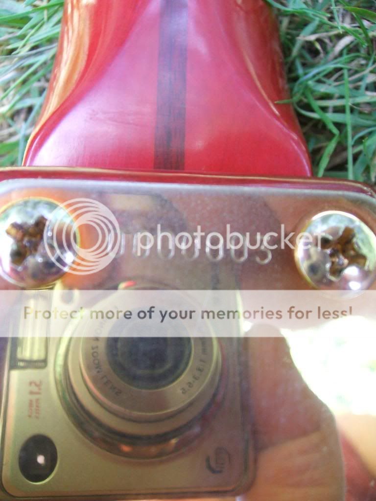

Peter Mac wrote:
ampmaker : please consider that Tokai may have started new numbering each year (ONLY a theory) for the first 3 years, I am quite sure that if they were sequential but spread out between ST and LS/LC models then by 1980, a new sequence would have begun once they hit the 10,000 mark.
I stopped looking and recording about 8yrs ago. (I remember Andrew, I bought at least one guitar through him.) The complete list of early serial numbers I recorded was:
8000316
8000349
8001443
8001634
8001840
8001946
9002203
9002348
9004497
9006967
9008977
0005475
0006760
0008147
0008912
0008992
0009554
0009655
0009903
0009903
0010245
0010754
0011173
0012658
0013024
0014106
1010523
1011071
1011104
1011954
1012970
1013391
1013587
1013659
1013871
1014602
1014917
1015109
1015698
1016323
1016958
1017084
1017828
1018834
1022403
1024095
1024659
So '78 and '79 here show no overlap, and things went a bit odd in '80 (overlap shown in bold). In fact, the almost complete lack of later year codes with very low serial number is what leads me to believe that Tokai at least tried for a couple of years to have a consecutive numbering scheme. Perhaps, as they made more and more guitars, the numbering and production process got out of sync? (shrug)
Within my numbers may be fakes (a little less likely back then), swapped Freplica neck plates and/or some confusion over other Japanese brands. I just didn't record the finer details that you guys have done.
If I check the difference between the lowest and highest serial numbers for each of the first few years, I get a very rough (i.e. under estimate) idea of production numbers:
1978 = 1630
1979 = 6774
1980 = 8631
1981 = 14136
1982 = 15868
1983 = 22550
1984 = 26287

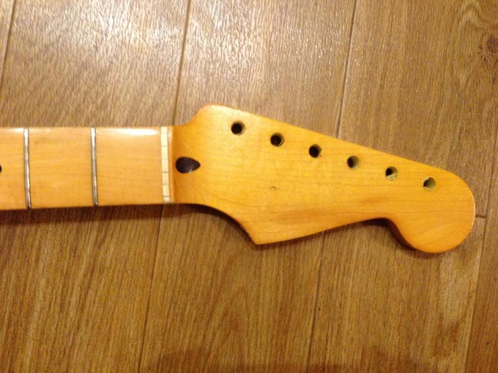

PostPosted: Sat Sep 14, 2013 10:18 am    Post subject: Reply with quote
I'm taking some pics during the cleanup and setup, and the reinstatement of the spaghetti logo...
The nickel plating was worn or scratched off in many places. Just a quick polish up to remove the worst, but to keep the aged look. Before and after on the left and right:
The headstock was in pretty poor condition. The spaghetti logo wasn't delicately scratched off. The marks were a lot deeper than necessary and went well into the wood:
Sanding the nitro off the headstock with wet & dry 240, 400, then 600 grit:
Sanded and dry, ready for a thin coat of amber nitro first:
This is about as close as I can get to the correct colour. I'll let natural nitro ageing do the rest:

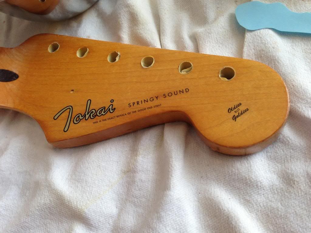

PostPosted: Mon Sep 16, 2013 7:39 am    Post subject: Reply with quote
Applying the decal:
Properly positioned now:
Posts: 8967
PostPosted: Mon Sep 16, 2013 7:46 am    Post subject: Reply with quote
Nice work... looks good. Quarter sawn wood?
Suki
Joined: 22 Feb 2013
Posts: 319
PostPosted: Mon Sep 16, 2013 7:57 am    Post subject: Reply with quote
Thanks - not sure about the cut - any grain experts out there?
