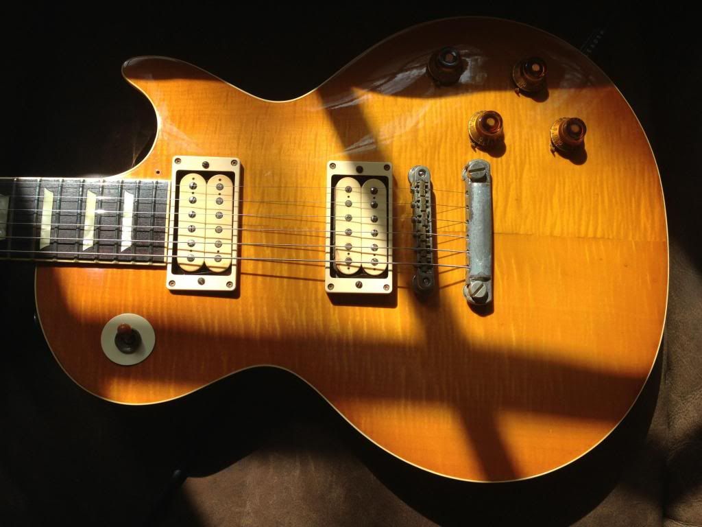

I just got an LS120 that is amazing.
The only issue it has is that there is some separation along the center seam of the top.
I had thought it might be a solid top since the separation was in the center, but no such luck.
I am guessing it must have been in a moist environment or something.
I am waiting to hear back from a local luthier to see if he thinks he can close up the separation. Looks like it's about 1/64" at most, and only goes down into the cap about 1/4" if that.
Anyway, I love this guitar! It sounds absolutely incredible and the action is so low and fast I feel like it's playing itself. Truly magical IMHO.
Just thought I would share.

I dont you can repair it, best to leave it, its a cosmetic issue not a playability one..

Agree with Villager, unless your luthier is confident, don't mess with it

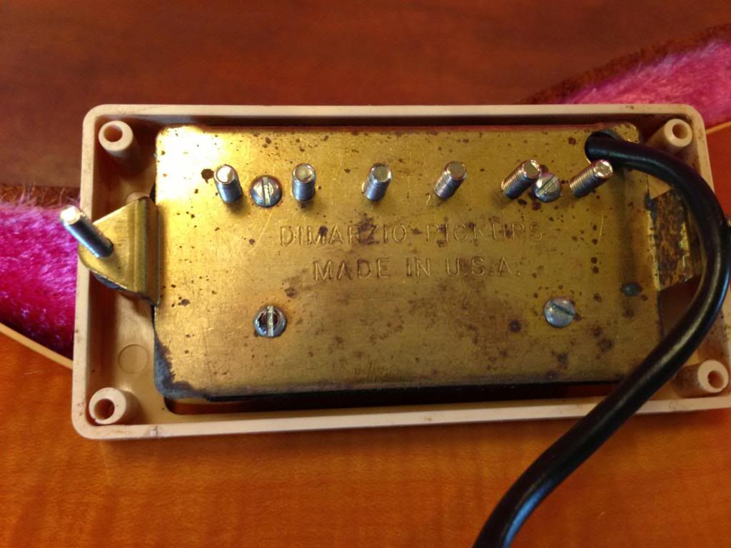

my favourite colour, would that be dimarzio's in there as well?

Thanks guys! Yep DiMarzios and it sounds AMAZING!!!!

Gorgeous top on that one!

Thanks guys. This is the Les Paul I was always after.
I will wait and see how the weather in the southeastern US affects the seam separation. It can get fairly humid here in summer. If it closes up more I will have it glued, and then fill whatever is left and try to color match, then cover with nitro cellulose.

Happy for you, thats gorgeous man.

Does anyone know what kind of fretboards these had? Looks like a dark rosewood. I assume Indian rosewood.

wow!!! nice one
and compliments on the photography....good placement and stunning light.

Yep indian rosewood

Just heard back from my favorite luthier. My plan is to let it acclimate here in the humid southeast for a few more weeks, then if it's still open have him re-humidify it to Gibson specs and see if it closes, then glue it with thin glue that seeps into small openings. He also suggested testing using a little bleach in a hidden spot under the pup ring to see if he can remove some of the dirt that has built up around the separation.
Will take it slow since I love this guitar so much.
