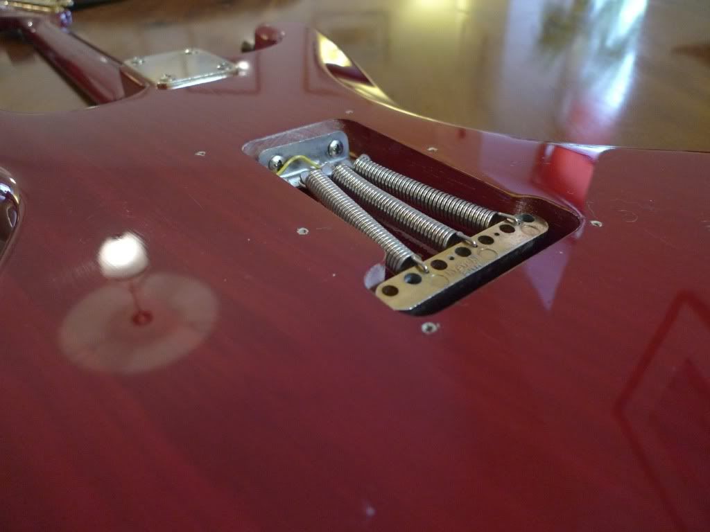

No "100" stamp. It was a Golden Sunburst to begin with, there's still a GS mark in the cavity under the red, so an ST100 which had been returned to Tokai for 'enhancements'. 8)

Have some pics somewhere....hang on..
Here we go..
There's a 7.....can't make out much else..
And the neck..
So they share a 7 at least! :D
