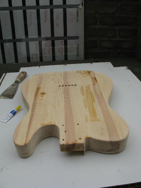

This build hasn't been updated in a while, mostly because I've been busy making ???. With Easter's long weekend and all I thought I'd see if I could get in some trouble in the garage.
A new roundover bit (3,3mm or 1/8" radius) arrived by mail a week or so ago and I thought I'd give it a go. Went well on a scrap and fabulous on the body itself;
That is after some light sanding to take out the minimal amount of router seam.
Then I thought I'd address what was left visible and tangible of the breakouts that template routing had left;
Not sure if that was a wise decision to use CA glue to fill those tiny tearouts... We'll see if it was or wasn't tomorrow...
