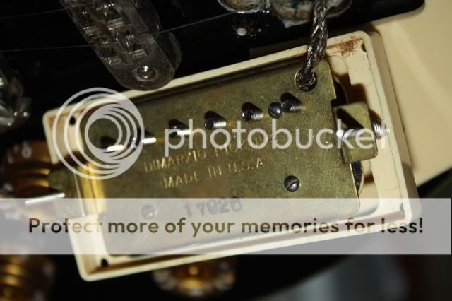

PostPosted: Thu Oct 13, 2011 5:12 am    Post subject: Reply with quote
1977 seems to be a good year for '1' coded pickups, here's a few
DiMarzio PAF with Maxon code from an october 1977 EG900
U2000 from a january 1978 EG700

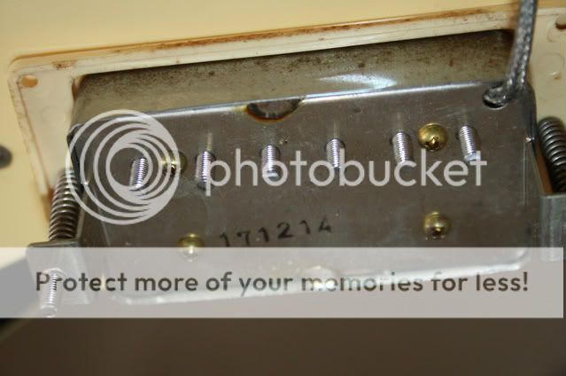

PostPosted: Fri Oct 17, 2014 5:34 pm    Post subject: 78 Greco EG700 Reply with quote
Hi, I know this is an old thread but was hoping someone might be able to help me.
The pic of the 1978 EG700 pup(code#171214) that jacco posted is one of the pics from the ebay listing for the black 1978 EG700(serial#A786076) I purchased from chingo123. The production dates for the guitar and pups are very close which leads me to believe they are original to the guitar.
I have read that eg700's came stock with u-2000 pickups but have also read that the maxon codes went as such:
codes starting with 1 were u-1000, 2=u-2000,3=u-3000 etc...
Can anybody shed any light on the matter for me?
Thx,
Jibby.
PostPosted: Sat Oct 18, 2014 12:41 am    Post subject: Re: 78 Greco EG700 Reply with quote
Hi Jibby!
This part is incorrect:
jib by wrote:
..but have also read that the maxon codes went as such:

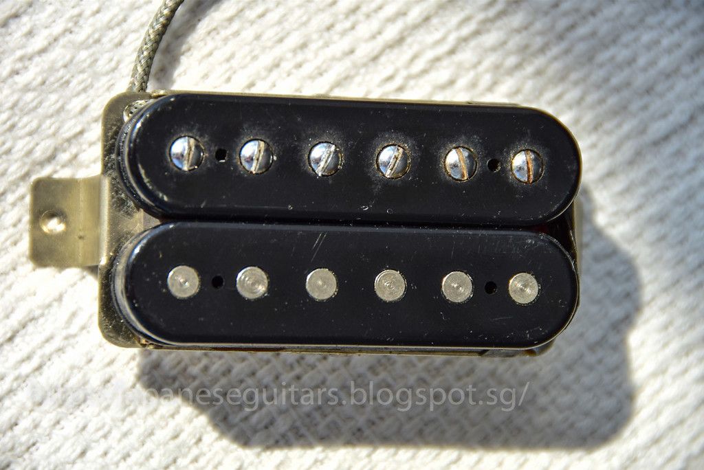

PostPosted: Thu Apr 23, 2015 2:02 am    Post subject: Reply with quote
The U-1000 pickups from the "Super 70" classic period (which is around the mid/late 70s), have Alnico 8 magnets.
The U-2000 had an Alnico 5 magnet btw.
The Maxon made "Super 70" and the Maxon made U-1000 were the lowest pickup model in the available pickup model lines and the lowest Maxon made pickups got Alnico 8 magnets.
The photos below show a U-1000 pickup from 1976 with an Alnico magnet (not ceramic) and anyone who has played a guitar with a U-1000 pickup will know that it's basically a Super 70 and the magnet is an Alnico 8.
The pickup specs changed when Fujigen took over pickup making from Maxon in late 1981.
There might be a possibility that later made Maxon U-1000 pickups from the late 70s/early 80s might have had ceramic magnets, I do not know because I've only had experience with 1977 and 1976 U-1000 pickups that had Alnico 8 magnets.
If someone doesn't like the Alnico 8 sound too much, then i's pretty easy to buy an Alnico 2 or Alnico 3 or Alnico 4 or Alnico 5 magnet and just replace the Alnico 8 magnet with whatever magnet.
Dry Z's are probably Alnico 3 because Maxon was also using Alnico 3 for the "Super 58's" but Alnico 2 and Alnico 4 and Alnico 5 all sound PAFish as well in various ways.
Gibson didn't use Alnico 8 or ceramic in the early PAF's.
Greco Maxon U-1000 pickup from 1976, and the Alnico magnet is pretty easy to see (bright shiny metal magnet).
Alnico magnets are metal and ceramic magnets are different, and alnico magnets can be tested with a multimeter signal continuity tester (place the multimeters probes on 2 different points on the magnet) as the metal will conduct the multimeters continuity signal (usually the multimeter beeps when there is continuity of the signal) and the ceramics will not conduct the multimeters continuity signal.
