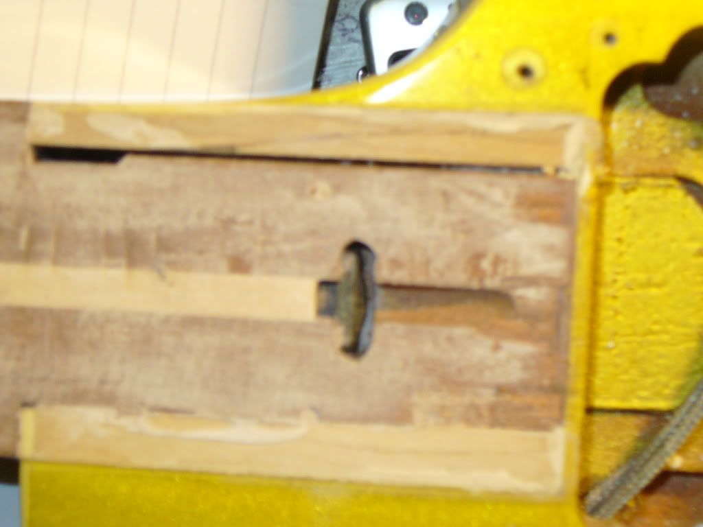

PostPosted: Mon Apr 18, 2011 5:00 pm    Post subject: Nice Reply with quote
Or not.
Too many of the Japanese Lesters passing through my hands look like this:
Note the 2mm gap between the neck and the body on the left side and the large cavity on the right side.
t.olsen

I have had the "opportunity" to remove the fretboard on two and both had extremely mediocre craftmanship in the neck pocket.

Well, perhaps an apprentice made a guitar every once in a while and the regular workers made a few mistakes once in a while, which of course is fully plausible. But I find it hard that the two I got to remove the frtboard from came from such batches. The chance/risk is just too small that it happens.
The first Burny look horrible. The other two looked alright in the p.u cavity but horrible under the fretboard.
My guess is that they weren't too fuzzy about things.
If I ever have the opportunity to remove a fretboard again I hope it looks good and has no horrible gaps on the sides of the neck.

The custom is the Burny I guess and looks like a Dyna made one. Those are the only Burny's I've seen this happen. late 80s, early 90s right?
The GT is not a Burny.
The burst can be a Burny, but only a 1992/1993 LG75GR model made by Fujigen.
I'm guessing they're all late 80s/early 90s models, not the best period of Japanese craftmanship.
Besides that: maybe it's also a matter of being lower end models
PostPosted: Wed Apr 20, 2011 8:55 am    Post subject: Reply with quote
The burst is just what you pointed out.
The blue one was a late 80's Custom.
The Goldtop was a 1982 Mint collection Greco GT
To find flaws like these gaps in the neck pockets one usually must remove the fretboard. Both the Custom and the GT looked fine before I removed the fretboards but then I was rather disappointed.
My mate removed the fretboard on a 83-84-ish Mint Collection flametop and it also had "wide" gaps on the sides. Same mate also removed the fretboard on a Burny Super Grade GT from the first years and it had gaps as well.
I have no idea what models those were but I think the Flametop was a 65.

Those were dowels weren't they, not just plugs? I would guess that the dowels are about a couple inches long on the Super Real joints?
I get the idea of using the system in that it increases the contact area between the neck and body joint and kind of locks the neck into the body, but it also adds extra glue joints.

Well, why not do it properly from the beginning and make a neck that sits tight in the joint? No, of course not, precision costs money!

Would there be a reason to use such plugs if the neck and the pocket had micrometer precision?
I haven't yet had the pleasure to rip the fretboard of a Super Real EGF but I will when the opportunity comes.
Personally, I think they will look as shitty as the others.
