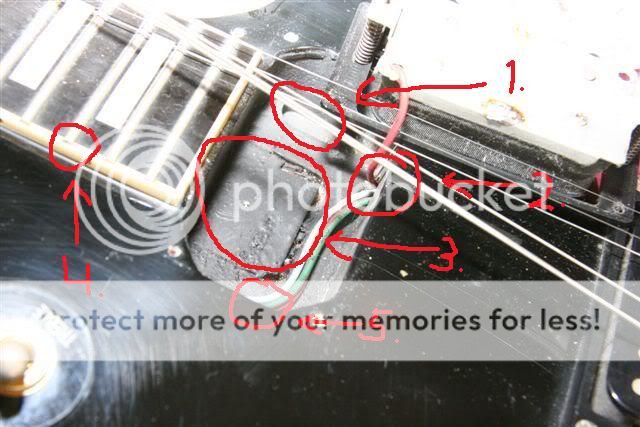

Could anyone post a picture or two, of the differences between the Cort and Tokai made Greco LP Custom?
Here is a picture of how it looks. It has the same wire and tenon - but not the "egc 75" stamp.
http://i456.photobucket.com/albums/qq282/clines99/tok/212d-3.jpg
japanstrat
Joined: 23 Sep 2006
Posts: 879
PostPosted: Thu Mar 24, 2011 4:58 am    Post subject: Reply with quote
That's a Tokai made Greco.
Note the 2 square shaped shallow holes on each side of the bottom of the pickup cavity, that's done by a Tokai factory router.

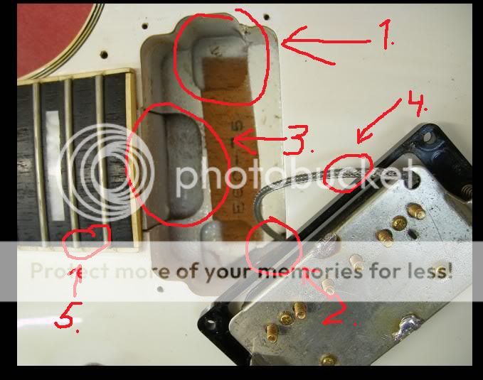

PostPosted: Thu Mar 24, 2011 5:37 am    Post subject: Reply with quote
Differences between Tokai & Cort made Greco's from this picture:
1. Tokai: square tab routing, Cort: oval tab routing
2. Tokai: diagonal wire routing, Cort: straight wire routing
3. Tokai: medium tenon, Cort: long tenon
4. Tokai: braided pup wire, Cort: coloured plastic pup wire
5. Tokai: fret edge binding, Cort: no fret edge binding
Tokai:
Cort:
