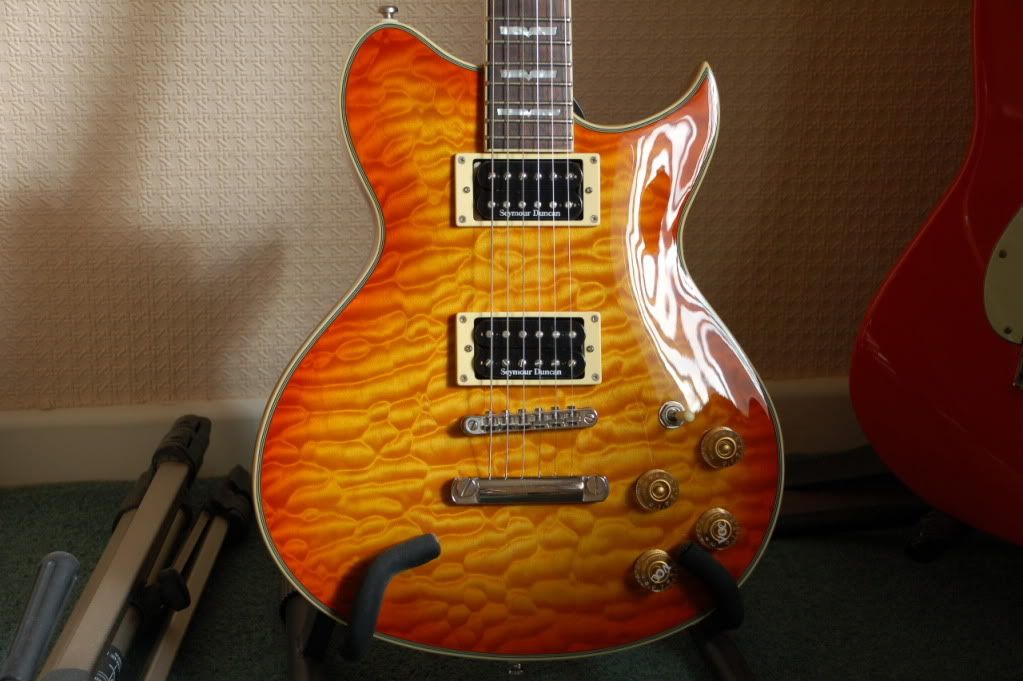

Saw this in the local paper for ?250, went to have a look and got it for ?150. Made in Korea 2006 mahogany body and neck, maple cap, SD '59
at the bridge and a Custom Custom at the neck. Buzz Feiten tuning system, VCC, (voice contour control) turns the H/Buckers into single coils
No big deal but it plays well and sounds well through my Romany in both H/bucking mode and single coil, the trouble is there is no real tone control
with this system. Has anybody had any experience of these?

Love the shape of that Pete, never played one but you got a great deal, buy two seymour duncans and get a free guitar :D

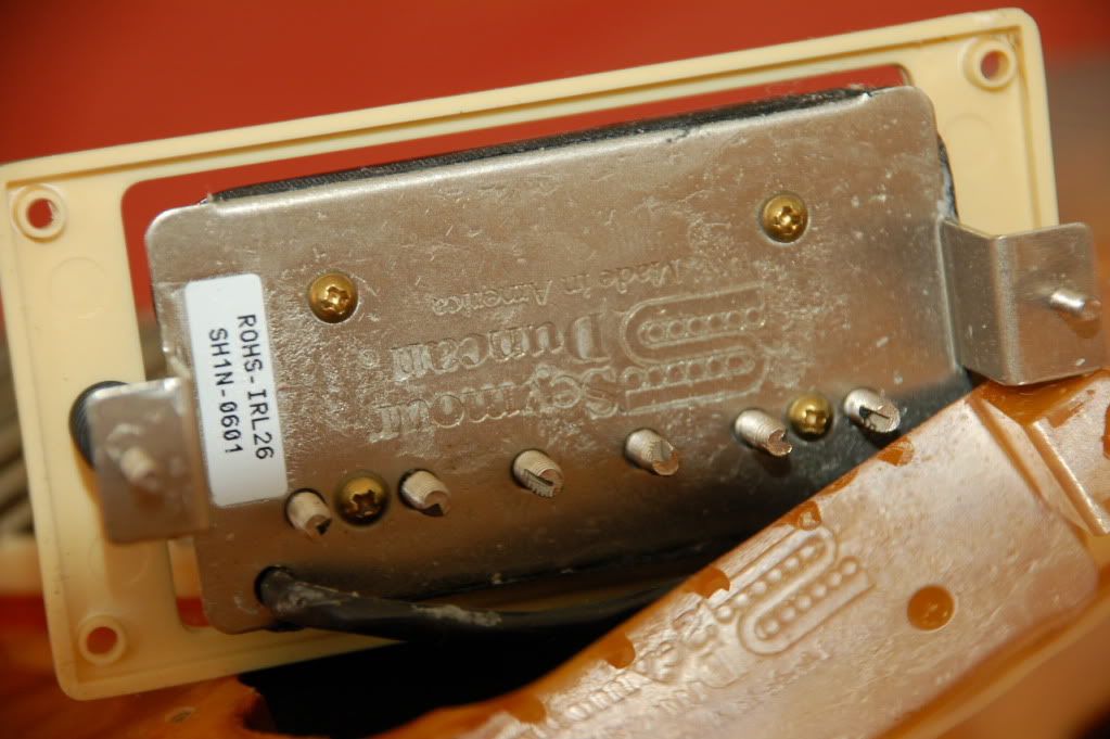

Yes its a kind of LP and Tele cross to me. I'm just wondering if they are real SDs or fakes, one says Made in America and the other Made in the USA.

I've played the one without the maple top, the wi65pro. Nice guitar, I didn't like the vcc either (i thought it switched to parallel wiring, though, but i could be wrong)- push-pulls along with a normal tone control would be much more useful if you ask me.
They came stock with duncans (custom custom and 59) so unless something weird's going on, i'm guessing your duncans are genuine.

here's a thought- on the duncan website the custom custom is supposedly from the pro shop. Might that explain the different markings on the back?
Easiest thing to do is just to ask at the duncan forum though, I'm guessing...

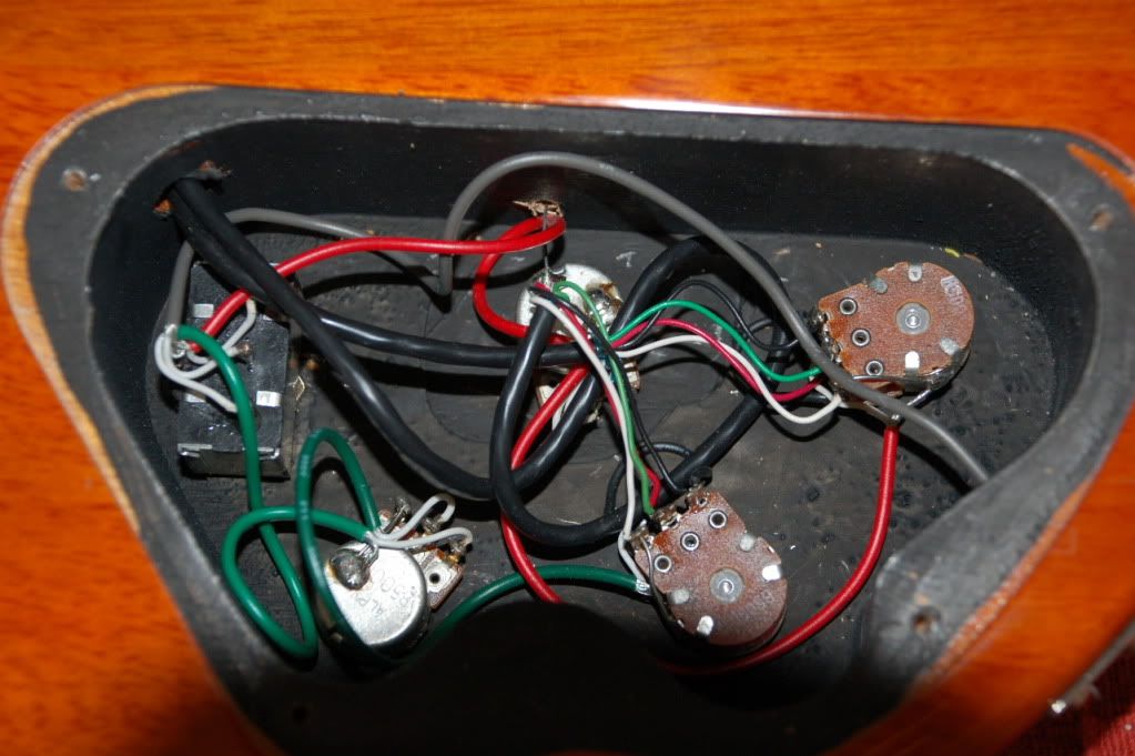

Thank you for your comments, I went to the SD forum and asked and they seem to think they are genuine and the writing on the back plates changed, the older ones have Made in the USA and the later ones Made in America. Would it be a big job to change to push pull on the tone pots, and being a Korean made guitar would the pots be metric? I'm not too clever with wiring so do you think it would be expensive to get done? All comments appreciated.

Pete, from your pictures it looks like your pickups only have two wires each (inc' the grounded outer sheath on the braided one) and you need each pickup to have 4 for push pull coil splitting.
See here
http://www.seymourduncan.com/support/wi ... _2t_3w_2pp
The conversion isn't expensive but you need the right pickups to be able to do it. Being Korean the pot's are almost certain to be metric.

Hi Dave thanks for that, I think you were looking at the wrong pictures, the pups with the braided wire were Stratman's mine are the ones above.
I think they do have 4 wires. Here is a picture of the control cavity.

Post by DaveWW » Sat Oct 16, 2010 4:29 am
Yep, that spaghetti looks like 4 wires :D The installed pots look like cheap small ones but you should be able to install full size metric ones.
