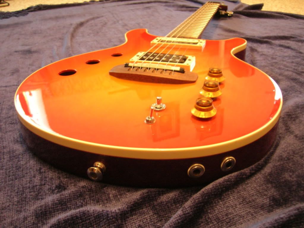

I have a Hamer DuoTone. 2 humbuckers and a piezo. But it has 2 jacks. One for the humbuckers and one for the piezo. With a 3 postion mini toggle. I have always sent the piezo direct thru the board and the humbuckers thru the amp. Works great. But it is pretty simple with the 2 output jacks...
