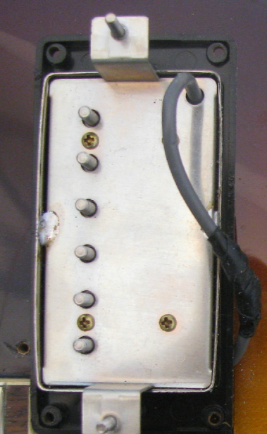

Could someone help me to identify this PU? (From a Burny 335)
Those are the post '87 re-issue VH1's which really are hotter than the originals and sound more similar to the VH2 or VH4 (the silver base and gray wire are also a give away).

How hot? (How many k?)
Does these have a ceramic magnet?

Can't say for sure but those I have had of this model have all been ceramic. Just take of the covers and check the magnets.
That ceramic comment had always made me curious so, I ve taken all mine apart.I've had several of these late 80's VH1's and have yet to find a ceramic magnet? I've taken them apart and all the ones I've had, have roughcast alnico magnets, like the old 50's style magnets. There black and unpolished on top and polished on the other side. unlike most modern alnico magents which are usually polished all around. As far as dc resistance. most were 8k-8.4k that I've had. Koubayashi, Do you have any you could post a pic of?

I have regarded those pickups as ceramic cause of the black end (and thrown them in the garbage).
:D I don't think you hurt anything so, it's all good :D Alot of pickup makers I've spoken too, say the old rough cast magnets have something to do with inductance and has some kind of effect on tone, what that effect is I don't know?
