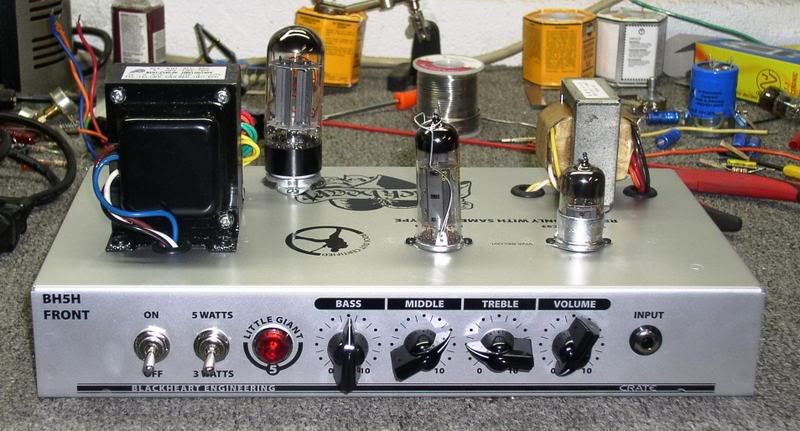

Of course I began tinkering with the tubes just 2 days later ?
I?ve found a TAD 12AX7-C and a NOS 5751 for the preamp section and a TAD EL-84-STR left in my pool box for the power ? I prefer the 5751 vs the AX7, because I had swapped it into my DRRI some time ago and noticed a tremendous upgrade in sound ( my personal taste )...
... and you remember perhaps that I own two 2x12 cabs with ToneTubby speakers and Weber Blue Dogs ?
So it's looking like this now ...
