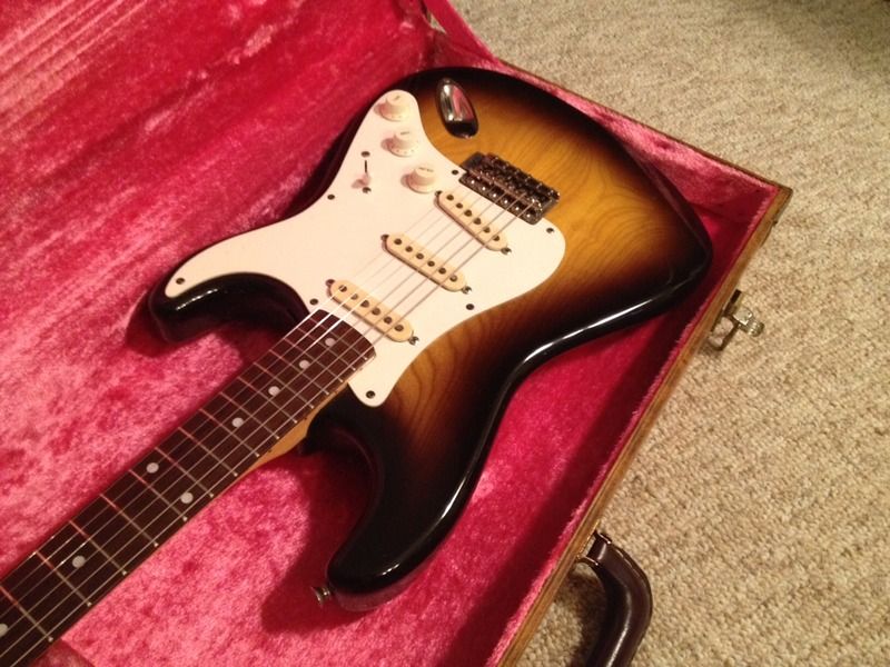

Posts: 9092
Post by marcusnieman » Wed Apr 25, 2018 3:28 pm
Fortunate enough to have a pair of ST80's - one with rosewood, one with maple.

Post by aroomstudios » Fri Apr 27, 2018 6:48 am
Well right now the St-100 has a E in the bridge and the middle. Then it has a Dimarzio in the neck. The neck is about twice as loud of the bridge or middle. So, using the 3 way switch right now is strange. If I do keep the E PUs I would have to find another one on Ebay or so and install it in the neck or just go all 3 different pickups.
