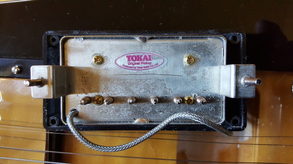

I'm still not sure what pickups are in my ES158 so here's a pic!
It's quite confusing because they are advertised as Gotoh MK2 pafs but there is no "Gotoh" on the pickup just Tokai's own brand.
The pics I have seen on other Gotoh pafs do have the word Gotoh written on them. The bridge is 11.11k.
I have had to set them much lower than I am used to but I have to admit they sound really, really good! They are very bell-like and 3D on the top strings. There is zero harshness or spike.
Dombat used the word gorgeous to describe them and I think he is right!!
EDIT: forgot to say they are F spaced. 51mm E to E rather than regular 48mm. Bridge lines up perfectly, neck a little out.

Could any of you more knowledgeable guys answer this query please!
This pickup is from my ES158. It is described as "Tokai PAF MK2".
It is a bridge pickup and the resistance is 11.11k.
Would this be a Keiyo made pickup for Tokai?
This pickup is from a 2011 ES135 also described as "Tokai PAF MK2" . It is also a bridge pickup that measures 8.63k.
Would this be a Gotoh made pickup for Tokai?
They both sound great but totally different!
Thanks.

Hiya, the top pickup is out of the ES158 which is 11.11k which I am assuming is a Keiyo made pickup.
The lower pic is of a pickup from a ES135 I picked up and is a different pickup with lower output but both are "Tokai PAF Mk2's".
I like the sound of both of them, especially the one in the ES135 and I might buy another for another semi I have.
If I knew what each was it might be easier to decide what a seller is actually selling to me....rather than just a Tokai PAF mk2.
Hope that helps!

luis wrote:
I would say 11 k bridge ones are Keiyo but not 100% sure. I just recall Gotoh engraved ones were PAF territoy readings 7-8 K (pre 2005) and 7-11k since 2005 (when Keiyo ones came on scene in Tokais). My guess is Tokai was trying to get new young customers hence the higer power bridge one, but just a gues....
Thanks Luis.
The bottom pickup is from a ES135 made in 2011.
As far as I can tell it is the original pickup and hasn't been changed so I would assume it was a Gotoh....but if they used Keiyo after 2005 it seems to be an oddity!
Maybe the previous owner did change the "original" Keiyo for a Gotoh......I'll look at the solder joints more closely!
Thanks for your help.
