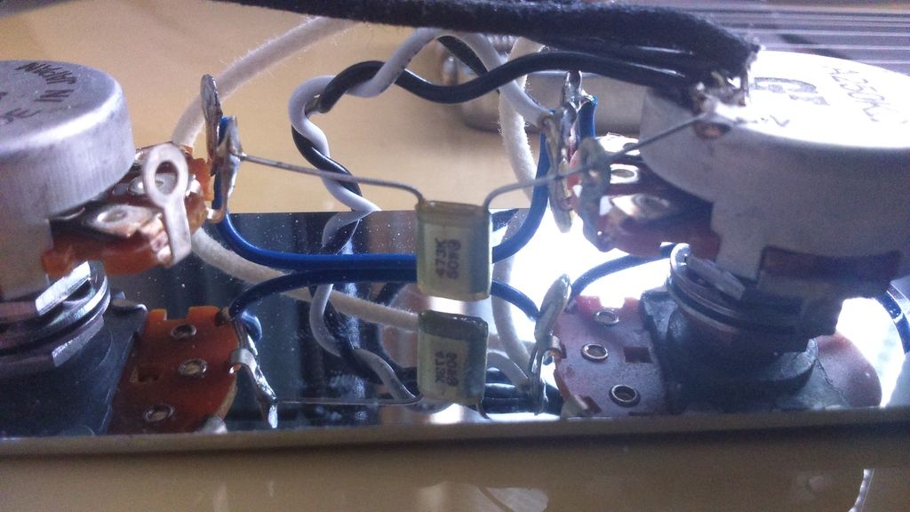

I opened mye guitar and looked, and there it is. 250k pots.
I am not an expert on tone caps and thought maybe someone could explain me a bit about the one i have taken picture of? It says 473k, 50w.
Is this normal parts for vintage tele?
Do anyone know about the quality of these parts?
Thanks.

250k pots are standard for fender-style single coils I think. Not so sure about the cap (shouldn't it list its capacitance?).
Does yours have a treble bleed cap on the volume? I think mine does (sounds like it does, anyway, I can't remember if I ever actually checked or not). It's not vintage accurate if it does (easily removed, though) but personally I prefer having one, it keeps the treble as you turn the volume knob down.

Those G pots are distributed in Europe by German retailer Goldo. I have got some 500K and 3 of them measure over 500 k (550,560 and 590 K no more no less). I am keeping those for some guitars in need of more treble sounding (no Love Rocks neded that in my experience).

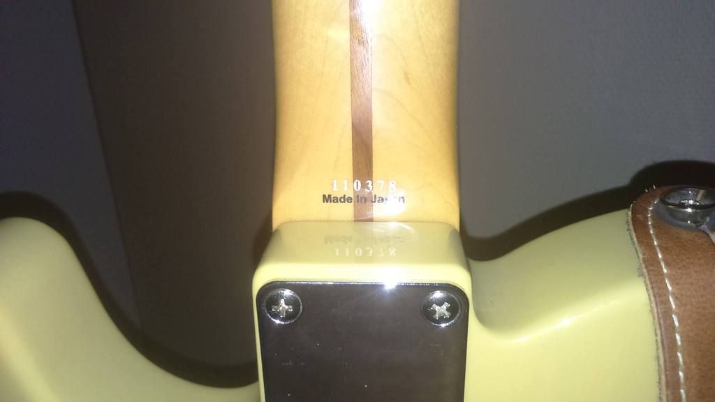

How can you know its a 2011? Is it some clues the serialnumber?
Posts: 2313
PostPosted: Sun Mar 06, 2016 8:04 am    Post subject: Reply with quote
Because neck and logo shape and Made in Japan at neck back end (Tokai released japanese TE AND TST models after parting with Fender around 2008....
Posts: 1276
PostPosted: Sun Mar 06, 2016 9:41 am    Post subject: Reply with quote
In regards to the serial number, i believe that it's a 2011 model because the serial number starts with 11.

Dave_Mc wrote:
Very nice That's not unlike mine.
In fact it does - 473K means 47 x 1000 which equals the value in picofarads: 47000 pf
We want micro farads which is the range that all guitar caps are. Pico is 10 to the minus 12 and micro is 10 to the minus 6, so move the decimal point 6 places to the left = 0.047uf. This is a normal cap for a Tele.
The "K" means 10% tolerance so this cap is 0.047uf +/-10%
A Les Paul will have 0.022uf, or sometimes 0.015uf on the neck pickup (ie the Clapton woman tone mod).
Don't bother remembering any of this, just remember which value cap you need when replacing them!
