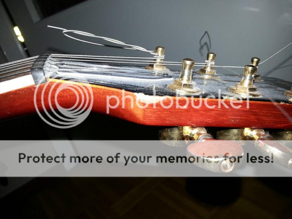

PostPosted: Sun Jan 18, 2015 3:27 am    Post subject: Reply with quote
Interesting guitar, thanks for posting pics.
Though I can't pinpoint this guitar to a certain factory, I'm leaning towards late 70s Japanese made. It's a 1977/1978 Kasuga type made guitar.
The reason I'm thinking Japanese is because of the fret edge binding and very similar build quality to known Japanese factories.
Late 70s because of the (non visible) short tenon, the green/yellow wire colour which was often seen during the 1977-1980 period and what seems to be pre CNC routing.
The most distinct part is the shape of the control cavity, especially the shape of the upper right lobe in the pic. I know I have seen it before, but can't remember where. I have too many pics
The problem with the late 70s is that most Japanese factories were changing their production process, resulting in gradual changes in the way they routed their guitars.
Also there were still many factories active and most of them produced under OEM.
A few questions:
1. Do the pots say 'Noble' on the side?
2. Are those digits in the neck pickup cavity? When you are holding the guitar upside down, does it start with 77?
3. Is the back & neck made of maho? Looks like bass wood to me??

Super thanks for great imput. Ok, last things first, starting with your questions:
1: Yep NOBLE15A500K
2: Seems to be, although covered with goo so very hard to make anything out of it. Id guess those are 7's as u say.
3: Yes it seems to be mahogany. Im no expert but wood seem very reddish and dark, even where the laquer is worn off. Also the pores are kind of big as in mahogany and the body have no lines as seem to be the case woth some basswood. But then again im no wood expert. Is there a way to tell? Top of the back of headstock have some worn off if i capped that in the pics. If not i can post a new one.
Can you or someone possible tell anything more about it? Kasuga? Is that any good? I have never seen a "vintage" logo in any of the listings from Japanese factories, or elsewhere except for the current vintage, but they assured they did not make it.
