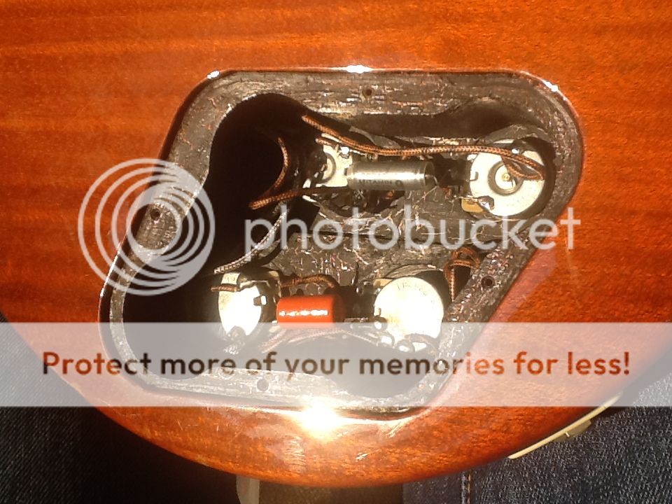

Here is the control cavity of my LS160s GT.
The neck volume and tone controls are the CTS type that Reborn mentioned. These are after market, the bridge controls are original to the guitar - though I want to replace them to be the same. All the wiring is original bar these two pots and silver cap.
