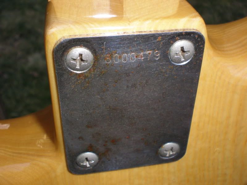

PostPosted: Fri Nov 15, 2013 11:42 am    Post subject: Reply with quote
The ST50N above is my guitar and I have a few questions......
The neck appears original per the codes but there is also the tooling marks in the neck cavity.I have inspected them and there is no evidence of being plugged.If someone were to drill and plug I would think the plug would be flush and not recessed. Also the serial number is pre 8002xxx and is stamped into the cover which I believe Peter said shouldn't be.The 50 stamp is also missing from the last fret??
PostPosted: Fri Nov 15, 2013 11:48 am    Post subject: Reply with quote
Model type stamp on body = no fretboard stamp. That is normal for 1978.
Normal neck plate = serial number etched on neck plate, small neck plate = serial number stamped on neck. So that's also normal.
hunter
Joined: 07 Sep 2007
Posts: 437
Location: Pennsylvania
PostPosted: Fri Nov 15, 2013 11:52 am    Post subject: Reply with quote
Thanks Jacco...I misunderstood what peter was saying
PostPosted: Fri Nov 15, 2013 12:07 pm    Post subject: Reply with quote
What Peter meant was that up to about 8002000 there's a mix of both small and normal neck plates. After that only the normal neck plate variety.
