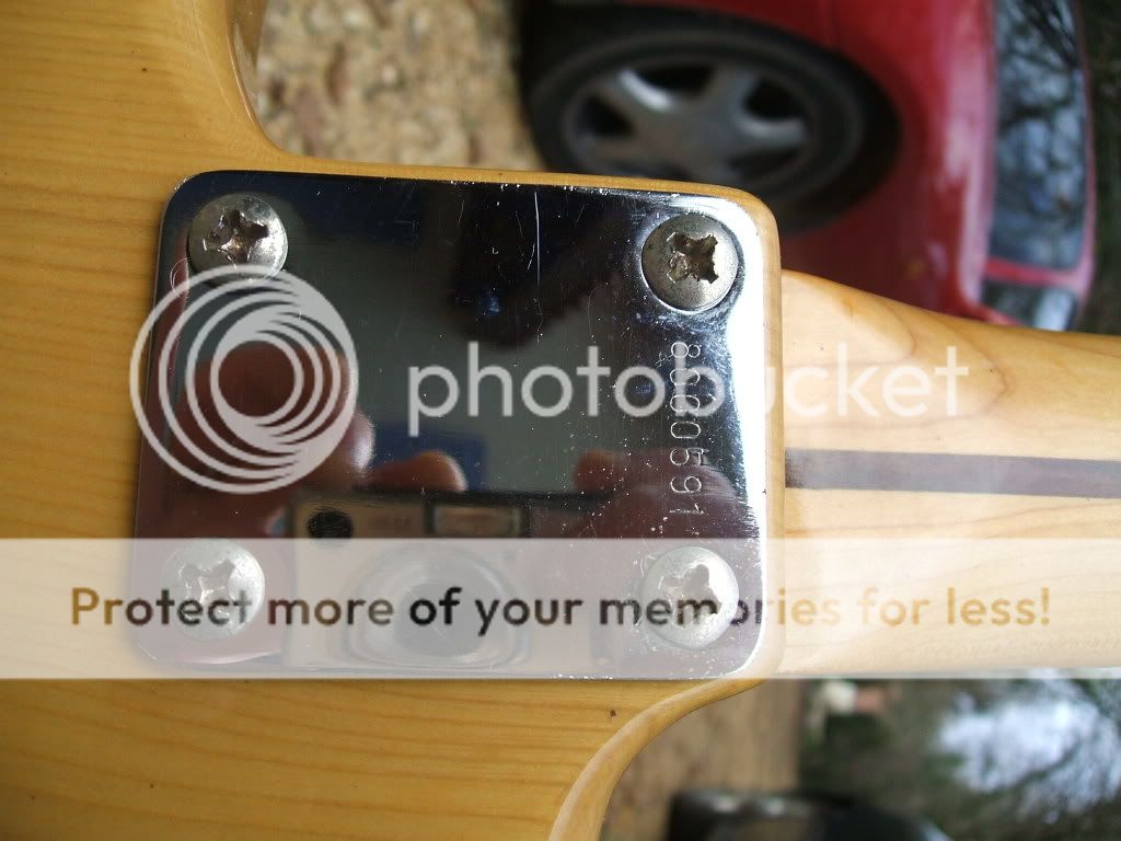

Here are some pics I found;
That's 8000760 & 8000664 on the same neck..
A very early 8000003 according to the seller
What abpout this early neck plate serial with normal width neck plate

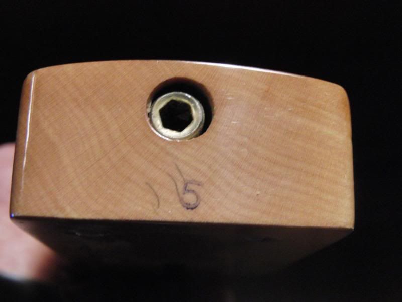

The white 78 ST60 with the two serial numbers in the pocket is mine. One correction to make.... there are not two serial numbers on the neck. It appears that they put two different necks in the pocket and the ink stamps for both transferred. Here's the neck on the guitar:
