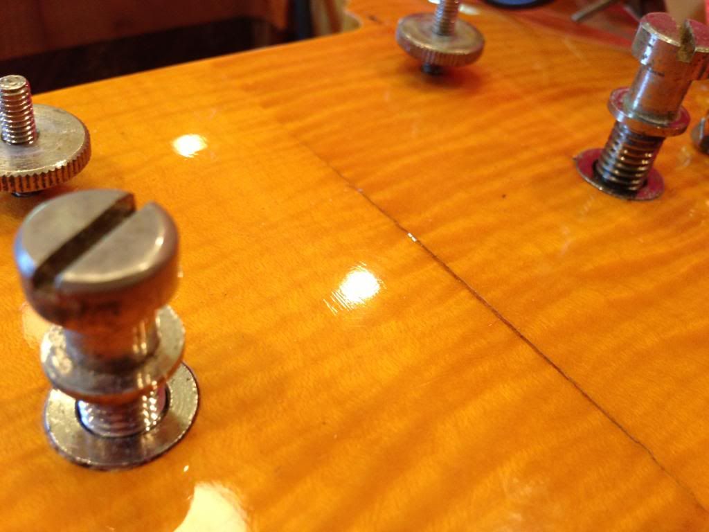

What does this mean? : re-humidify it to Gibson specs
The guitar must have been in a really dry environment in Japan.
He said the wood in Gibsons should be kept at 50% humidity at 70 degrees F I believe.

I just got this guitar back from my luthier.
It sat for months in a humid environment, and the separation closed back up almost totally.
The issue I have is that there is a darker stain along the crack from sweat or whatever getting in there. He tried cleaning it with bleach, but the stain didn't budge.
His suggestion was that if I was planning to keep the guitar, was to not glue or seal it. That if I do that then if I tried to re-finish it later it would be really hard to get that stuff out of the crack.
He is friends with Tom Murphy, and I have seen an incredible custom refinish Tom did on a Les Paul. He said Tom signs inside the pickup cavity then puts the finish over the top. Evidently that can boost the resale value on Gibsons anyway, enough that he thought it could pay for the refinish.
Just wondering what you guys thought should do?

PostPosted: Tue Jul 09, 2013 8:06 pm    Post subject: Reply with quote
Play it and don't fret too much about the cosmetics at this point.
