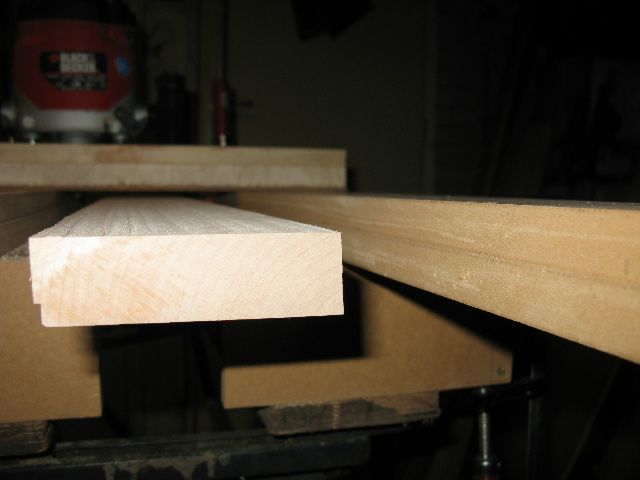

Need a straight, smooth edge and since I don't own a jointer, but do have a routertable (the same handheld B&D router is in that);
^^^ This is just a known and measured straight piece, doublestick taped to the neck blank to act as a guide to straighten it up with a template following bit.
Anyone has any questions or if you need additional pics, jump right in.

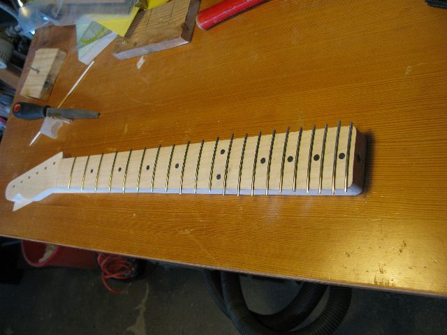

Layed out the frets for a 25"er. Need a tele that'll let me bend 11s up a whole step on the second fret without ripping my fingertips off. Or stringing up 9s.
va' sa' du? va' hete' du?

marked the locations for the dots;
I used a fence on the drillpress table to allow myself to exercise more control over the neck. Straight as an arrow;
I'll be glueing the dots in and while they dry I might just get started on the stringthru holes.

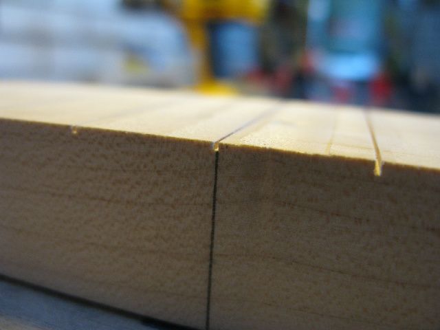

Not very scientific, not even very safe... Recutting fretslots;
To depth;
Two or three swipes with a triangle needle file, using little to no pressure;
Cut a piece of fretwire from a roll and bend it ever so slighty using thumbs and forefingers. I press the ends into the slot to have it seat like so;
Then lightly tap the ends with a soft hammer and work from the middle of the fret to tap it down;
