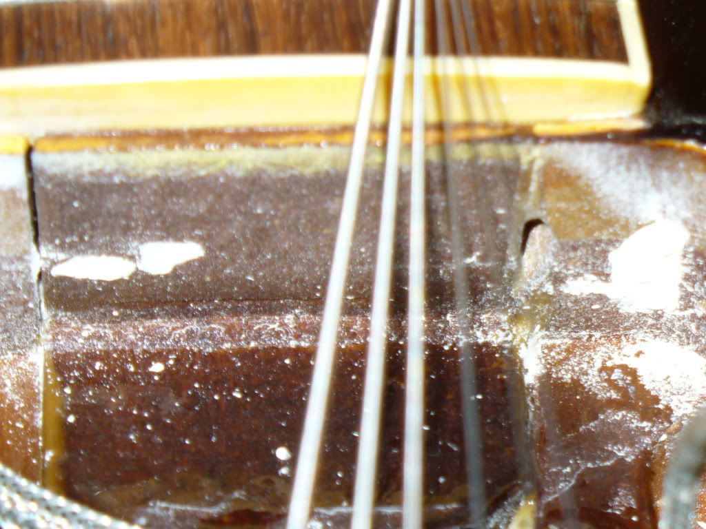

To find a 2mm gap on the one side and a 1mm gap on the other side of the neck cannot result in any positive conclusion.
That 1800 and the 1000 have miserable neck joints in my opinion.
For guitars at that price one would expect a bit more craftmanship.
The more I use my "critical glasses" the more horrified I get.

Here is Burny LG75GR
PostPosted: Sat Apr 23, 2011 2:11 am    Post subject: Reply with quote
Yes, that's the same one as earlier. What's wrong with it?

Which do you refer to?
The Burny is another one of same model.
you can see that it isnt the same since this one has no glue in that little cavity on the right side of the neck.
PostPosted: Sat Apr 23, 2011 2:32 am    Post subject: Reply with quote
Ah yeah, so what's wrong with it?
PostPosted: Sat Apr 23, 2011 2:38 am    Post subject: Reply with quote
Horrible gaps on each side of the neck.
I always thougt these had a lot of "string" in the sound.
Now I understand why.
Too bad I was too naive and believed in the hype before otherwise I would have had hundreds and hundreds of pics of terrible craftmanship.

Well, I think they do have to leave a bit of room to adjust the neck angle a bit, like putting on a Strat neck and getting it right before tightening the bolts.
I think I've seen Gibson ones that are not too pretty either.
Tenons are all BS to me, as long as the neck doesn't fall off and the neck contacts the body in some sort of way.
I've got Strats with large shims in them because I installed a Floyd and the neck is making a fair bit less contact with the body then before and they still sound ok to me.

Ok, can you describe the minimum requirements needed before you call a tenon joint 'good'? Please be specific.

Admittedly some of those pics don't look real good, but it would probably be good to get the opinion of a luthier to add to the discussion.
Surely there has to be a bit of a gap - for the glue? If the pieces fitted really tightly then the builder wouldn't be able to get a decent layer of glue in there.

Actually a mate of mine who is a luthier didn't like what he saw.
He thought it was a budget work.
And of course, these are mass produced guitars.
I have now mailed the pics to another luthier for a second opinion.

Wood against wood!
A 2mm layer of glue between two wood pieces surely must affect the tone.
